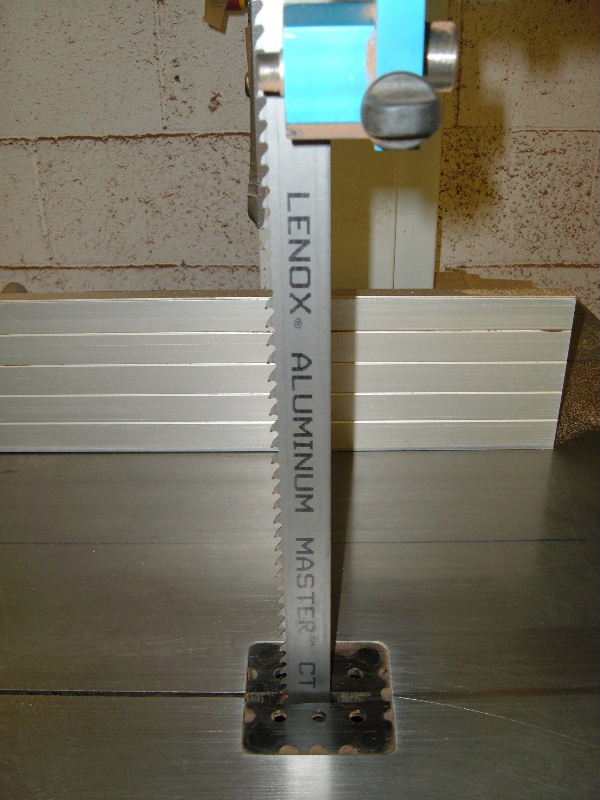

carbon bands run at 21,000psi optumum... what do you think carbide tipped bands run at? I think the bigger issue is beam strength of carbide tipped bands (other than the new alumimum Lenox Master) won't allow proper flexing around small saw wheels...gullet cracks galore. As always, I could be wrong

carbon bands run at 21,000psi optumum... what do you think carbide tipped bands run at? I think the bigger issue is beam strength of carbide tipped bands (other than the new alumimum Lenox Master) won't allow proper flexing around small saw wheels...gullet cracks galore. As always, I could be wrong [/QUOTE]
Larry - I haven't been able to find any source of aluminum bandsaw blades on the web. Have you got a link to a site that sells or describes them? (I tried a search for "aluminum lenox master" and some other combinations, too.)
Thanks, Phil

carbon bands run at 21,000psi optimum... what do you think carbide tipped bands run at? I think the bigger issue is beam strength of carbide tipped bands (other than the new alumimum Lenox Master) won't allow proper flexing around small saw wheels...gullet cracks galore. As always, I could be wrong [/QUOTE]
Thanks, Phil[/QUOTE]
Phil, Lenox shipped two aluminum bands directly to me for testing. There might be something on their website, but I've sent an email to my Lenox contact and will let you know when I hear back with some sourcing info. usually, Lenox is divided into districts and shops within your district would be your order source.
